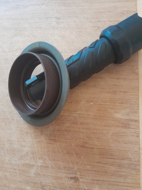

I'm making some progress. I identified the front diff. as a Dana 35. Found an exploded view and got the Spicer #'s, Passenger side 46066, Drivers 46065. I was wrong about the seal not having an edge to get behind. Just dirty and foggy glasses.(smile) I had to cross reference the Spicer #'s to an easier to find seal. It does indeed have a crazy looking "boot" on the outer side. I think I'm going to conquer this. I'll post a picture of the new seal when it arrives if I can.

Job is done. There is no room to install new seal right at the hub. You must find a piece of pipe or conduit to drive it in through the hole in the carriage where the bearing resides. I had to jack it up to get a straight shot with the piece of conduit. This was all done on the ground. Would be much less challenging on a lift.
