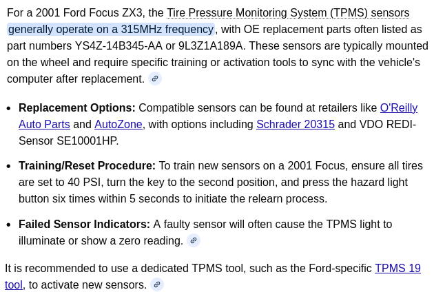

This might help...
When you do this, remember to also that to help train those sensors - if the new ones won't clear the dash light, you may need to do a battery reset (Pull + cable and short it to Ground and hold - while you wait 10 Min then reconnect) and follow the above procedure to force a relearn.
You should be able to stop at a local store (like where you bought the sensors - be sure to ask if they can help)) and see if they have a relearn tool there to help you. They can then help provide the tool for you to do the relearn process.
